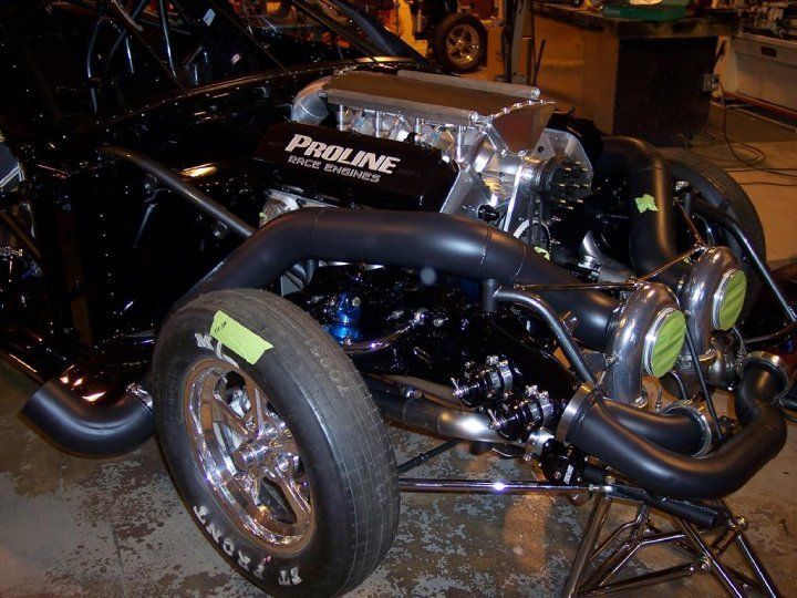

Btw op, satin black looks freaking good under the hood, and it's different than the std shinny headers everyone has. i'd say satin black for the win
I agree, black looks pretty sweet in many applications. This is a bit more extreme than Xeqshnr's application at about 4000hp, but you get the idea.
