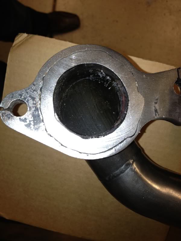

Not a true 1 3/4" hmmmm. Sorry about the upside down pic. I says 1.592"

1 3/4" headers are 1 3/4" OD measurement. I ordered the same header just now but Jethot coated.

I have them on, they are 1-3/4" I measured them because I had tricked myself into thinking I got 1-7/8"

Thats funny. in my profession we measure all pipe by the id. i guess you learn something new every day.

lifted from LS1tech:
Tubing => specified nominal value refers to outside diameter (O.D.)
Pipe => specified nominal value refers to inside diameter (I.D.)

Interesting. I work in refineries with both pipe and tubing. Both of which we measure by the ID. That includes some sweet stainless that we use for process instrumentation. I wish I could take some pictures but that's a no-no out here. Too many secrets.
