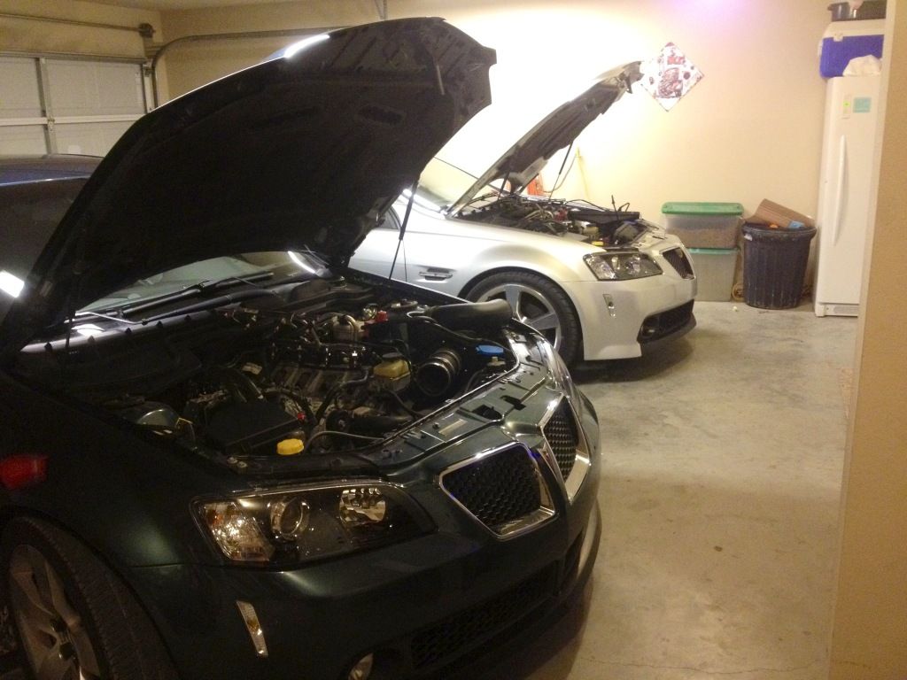

Posts: 1,036
Originally Posted by Aussie Dors View Post
Love the Kangaroo on the garage wall!!
Where did you get that from?
AD
It was actually part of a liquor store sign for a store that my business partner bought and renamed. He asked me if I wanted it and of course I said hell yeah. It was a one off, aluminum sign that was originally neon. The neon part was broken, so I backlit it with LED strips from Lowes that I can set to any color I want.
Here's a better picture.
