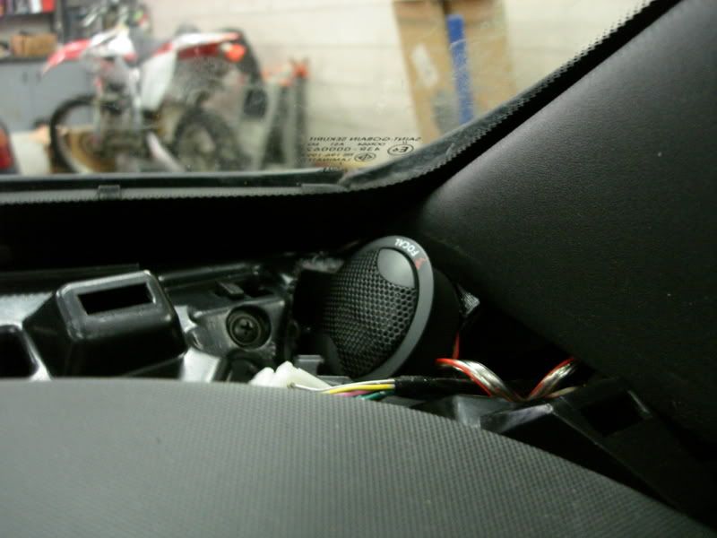

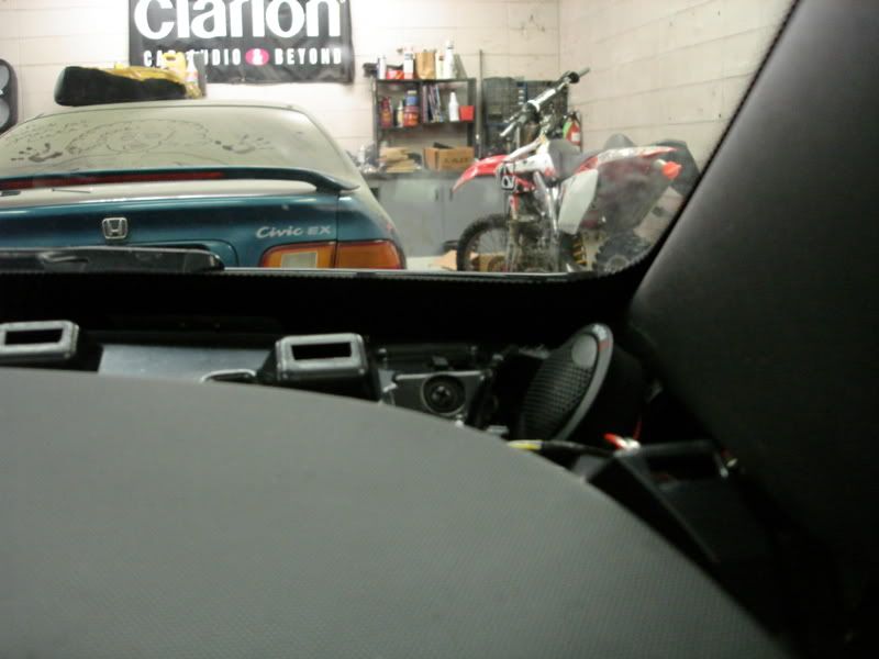

Here is what we have after removing the factory tweeter:

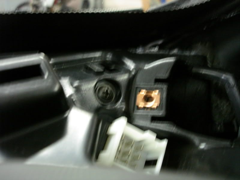

Disregard the location of the Focal tweeter. I already had it wired up and originally had it firing directly up through the factory grill. In pursuit of perfection I began modifying this area to fit it at the proper angle. The gold part where the screw for the factory tweeter mounts will be cut out as shown:
Now you have plenty of room to drop the large tweeter down below the point where the factory tweeter mounted. This will give you the clearance needed to angle the tweeter toward the center of the dash and still be able to fit the panel back on over the top of it.
You can see the same thing was done to the other side of the dash:
Factory bracket cut out:
Final placement of tweeter:
I stuffed a small amount of thick carpet underneath the tweeter and used some 3M velco in order to hold the tweeter in place. After its mounted securely you can begin reinstalling the panels. Take the tweeter panel and slide it forward and down back into place. You will have to again pry the vent out slightly so that the panel tucks behind it and fits back in properly.
After doing this you can reinstall the Apillar panel. It will slide down the A pillar and into the dash then pop back onto the Apillar with the two pins that hold it on. Don't forget to re-attach the plastic cable that keeps this panel from being launched at you should an accident occur that deploys the side curtain airbags. At this point you can enjoy your sound stage which will be much improved over simply firing the tweeters straight up through the factory grills. If you have any questions, feel free to ask!
