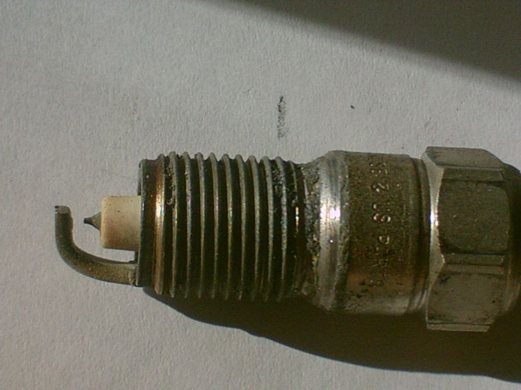

My gas mileage has been dropping down to high 18's to low 19's MPG when I used to get in the 20-22 range combined. Also, the car has felt sluggish and has been idling a bit on the rougher side. So I decided to try a cheap fix and change out the OE iridium spark plugs that were on the car since I bought it. The car has 56k miles on it. After pullling the plugs I could see why the car wasn't performing optimally. I thought these iridiums are supposed to last 100k. So anyways I went with NGK V-Power TR5 Copper Plugs and on startup I could definitely hear and feel the difference. Much much better idling, responsiveness, and smoother running all throughout. I'll run them for the next 15k and then check up on them.

The plug in the picture looks like an almost new Iridium plug to me

Plug looks just like the ones I took out of mine at 115K. No signs of wear on the electrode or ground. Fresh plugs never hurt anything though.

I agree with the last few posts. Look like the new stock ones to me. At least at the tip. I just changed mine this week with OE Iridium at 65,000. There was no reason for me to change other than I wanted to, and got plugs cheap with promotion deal. Car was running great, and still is.
The only thing that looks a little different from the plugs I pulled is yours have a lot of build up at the base of the treads. Mine were clean, just a little discolored.
??? Could you please explain what you see? None of us can see it. Looks like you wasted time and money switching to a less durable plug to me. What are we missing?

Lost as well... Do note there a millions of explosions that these spark plugs see, so a little discoloration is normal. If they were black and full of sutt then i would understand why.

My mistake. I jumped the gun and thought there was premature wear on the electrode tips but i can now see there is none after doing more thorough research.
I did find that the gap was .035 on cyl 6 plug and .037 on cyl 8 plug. All the other plugs were fine at or very close to .040.
Could that have been the issue? In hindsight i should have just regapped those two plugs and reinstalled if that was the problem.

Iridium plugs do look odd in comparison to the old style.

Be careful with regapping Iridiums. The harder material is also more brittle. .035 might be getting a bit small on gap -- but it would have been that way since new (with use, gaps grow).
