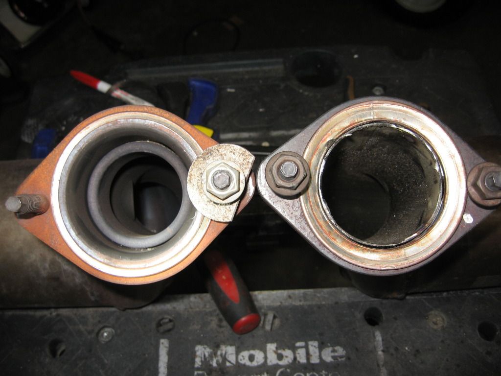

Ok I'll go a different path. Why are you looking at headers? On the GT, the exhaust restriction is in the flex above the cats. , next would be the cats, then the output of the cats and further down the pipe there is a crimp near the tunnel brace. In theory, as you get further from the engine, diameter can be less as the exhaust velocity and volume decreases with temperature.
That all typed, knowing what I know now, if NA, I would use the stock manifolds - they flow well, much better than 10yrs ago, then have a exhaust shop fab up a "test pipe" to replace the cats - 3 In inlet and 2.5in ball outlet. Then get a true 2.5in catback. If you plan to go with boost later, then headers make sense, but as stated earlier, the manzo will need to have the collectors replaced for the headers to work. Be conscious of diameter - otherwise just poser headers.
Here is a article to learn about exhaust: Auto Exhaust Science
here is an example showing the restriction inside the flex:
