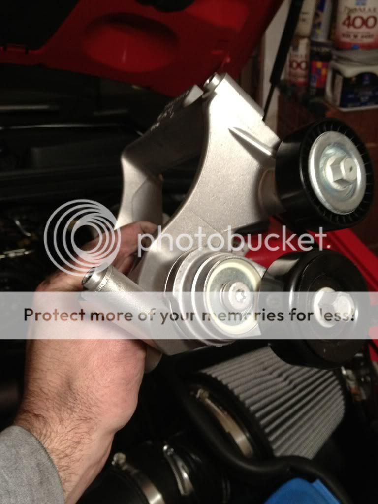

Here is a picture of the old tensioner and the new tensioner with the added idle pulley.

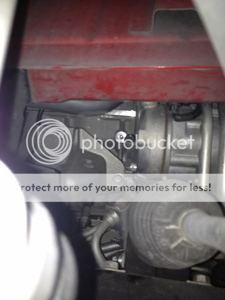

The AC compressor is located here and the tensioner bracket is sandwiched between the compressor and the engine.

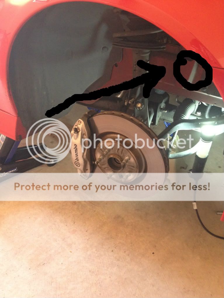

Remove the passenger side front wheel and either use a lift of jack stands to get the car off the ground. You need some room, so if using jack stands, get it up as high as you can, while still being able to reach in from the top to take out or put in a couple of bolts on the top of the tensioner.
The AC compressor and tensioner are behind the struts for the passenger front wheel.

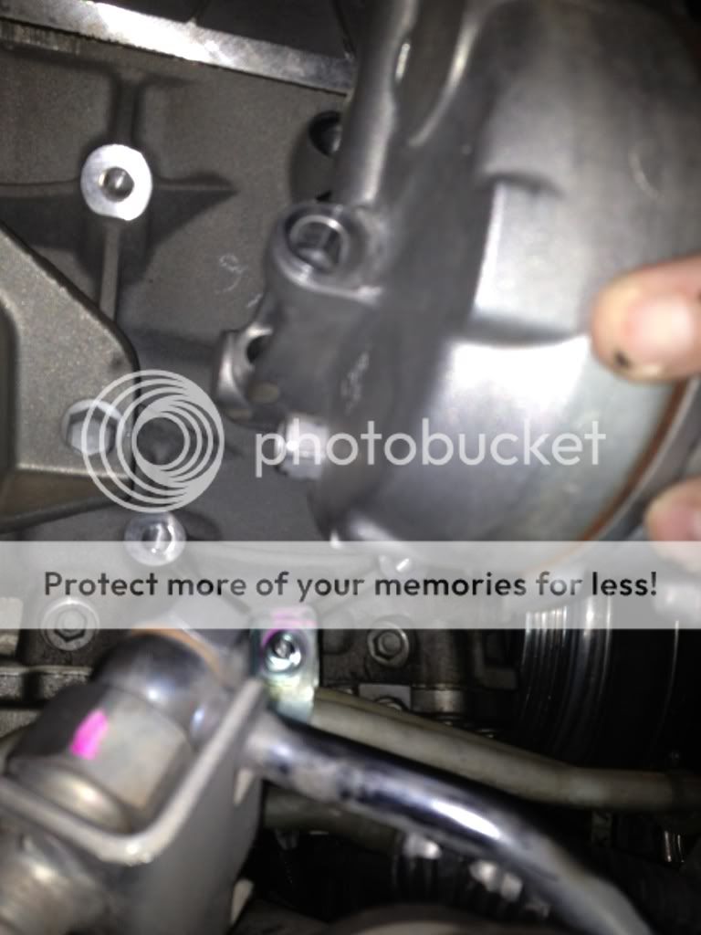

Remove the nut holding the AC lines to the tensioner. You can find it in my pic by looking for the piece painted pink that's attached to the tensioner, at least on my car.

This was the hardest part for me. Now, push the AC compressor as far forward, up and out as you can to make room for your socket wrench to get in the hole for the center bolt on the tensioner, behind the AC compressor. My socket wrench was too thick to fit and I had to go buy a lower profile/thinner socket wrench and shorter socket.
Once I had a lower profile wrench, it fit in the space easier, but once you get the bolt loosened enough to turn by hand, pull out your socket wrench or it will get stuck on the AC compressor and you won’t be able to remove it. Hand-loosen the bolt the rest of the way. It requires some force and jiggling of both the AC compressor and the bolt to fully remove it.

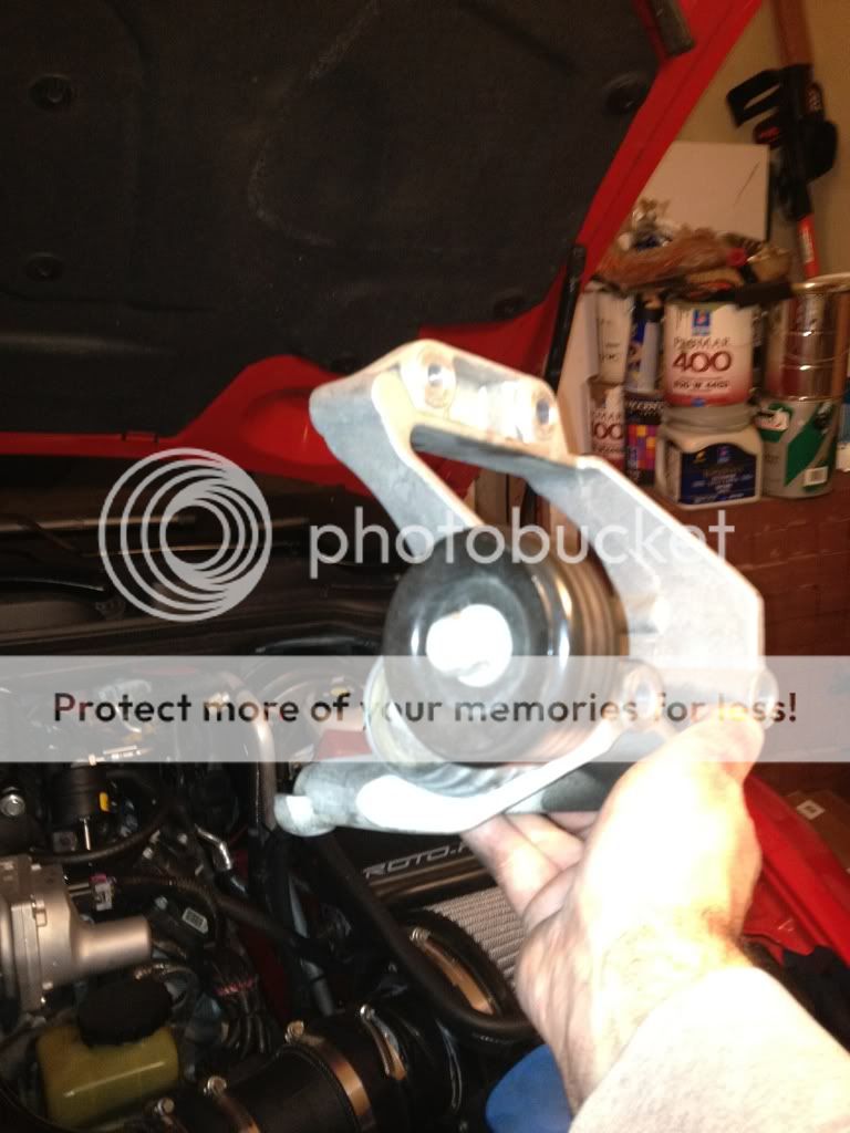

Reverse the procedure to install the new tensioner. Here is a pic of it installed.

Solid write up! I was able to pull the old bracket out through the wheel well opening.
