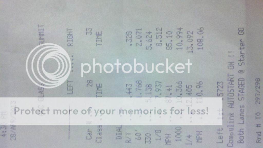

Took the g8 out saturday for the first time with the tune an lt's, already have exhaust an vararam. Well long story short I left pretty dissatisfied, I got some mt radials on gto 17s. I had ran 13.3 @106 before at the same track with just the vararam an exhaust. Here's the slip, an imput to why it wouldn't 60ft under 2.0? I cut 2.0 60fts with the stock 19s so im confused the radials didn't. I tried stalling it up mashing it nothing changed.

What were the temps and DA? These could possibly be factors. As far as the 60ft goes I'm not sure, I figure the radials would improve it.

Kyle you were flyin' down there. Nothing wrong with those numbers bro!!! :)

I think when I swapped to skinnies up front I was able to get down to a 1.93 on the stock converter.
I ran a 1.955 60Ft yesterday on stock converter and stock 18" RSA's. First run of the day on a nicely preped track. I would think a better tire would help a little but probably right, you need the Converter to get the RPMs up. According to my HPT log, a brake torque only got it up to 1500 RPM.

For whatever reason, I ran better 60's on A/S tires with the stock 245/45/18 size tires, than what I ever did on 17" wheels and 275/40/17 MT's, at the same track.
With A/S it was 1.95 60's 8 out 10 times, never did better than 2.0 60's with the MT's and stock verter. The stock verter, at least in my case, didn't like to be brake stalled. some people have claimed good results using this technique, never worked in my car, with the aftermarket verter i'm launching at around 1500-1800rpm, and my 60 is down to 1.74-1.76.
I'll be trying M&H 255/40/17 tires once i'm done with my Toyo DR's, I still think the smaller 275/40/17 tire is hurting my launches, so I want to try a 28" tire instead and see what happens.
