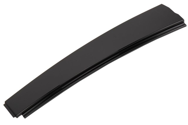

Based on only seeing a single vertical trim panel, am I looking at the vertical plastic trim piece located between the moveable an fixed glass portion on the rear door ?

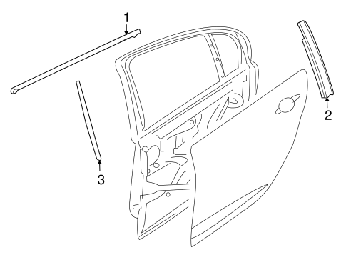

The best I can understand by words and pictures found on GM's IPC, is the following. The drivers side is called "F channel" with a a P/N 92233116 for $171. Passenger side is called "Pitch black gloss passenger side rear door stationary window channel" with a P?N 92233115 for $134 It looks like these items (besides the visual portion between the movable an fixed glass), also appears to include the channel guide for the trailing edge of the moveable glass. For sure you should visit a good GM parts department with these 2 P/N's and verify (at those prices) that they are what you are talking about. Can try to post R&R info from the service manual if actually needed.

Exterior Trim - Rear Door for 2009 Pontiac G8 #0
92277518 - Body: Belt Weather-strip for GM Image
92277518 - Body: Belt Weather-strip for GM Image Placeholder
1. Passenger Side Rear Door Window Belt Molding 92277518 Belt Weather-strip, Right Enhances the appearance of your vehicle's door window.
92206502 - Body: Belt Weather-strip for GM Image
92206502 - Body: Belt Weather-strip for GM Image Placeholder
1. Belt Weather-Strip 92206502 Belt Weather-strip, Left
92255725 - Body: Applique for GM Image
92255725 - Body: Applique for GM Image Placeholder
2. Pitch Black Gloss Driver Side Rear Door Window Frame Front Applique 92255725 Applique, Left Front. Helps protect and enhance the appearance of your vehicle's door.
92255726 - Body: Applique for GM Image
92255726 - Body: Applique for GM Image Placeholder
2. Pitch Black Gloss Passenger Side Rear Door Window Frame Front Applique 92255726 Applique, Right Front. Helps protect and enhance the appearance of your vehicle's door.
92233115 - Body: Division Channel for GM Image
92233115 - Body: Division Channel for GM Image Placeholder
3. Pitch Black Gloss Passenger Side Rear Door Stationary Window Channel 92233115
Division Channel, Right Rear. Helps provide a seal for your vehicle's window. Helps guide the window while it is being operated.

The vertical pieces are called appliques. Will look later for removal instructions.

Gotcha. The applique around the rear "quarter" window glass. Diagram only list the glass. Window, Rear S/D Sta (W/Rear S/D Wdo W/Str) 92254935 Fixed Glass, Left Replaces: 92235191, 92262296.
