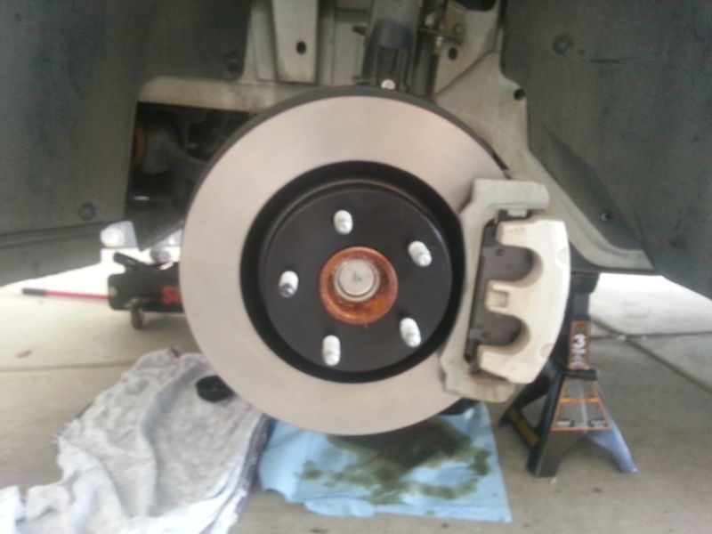

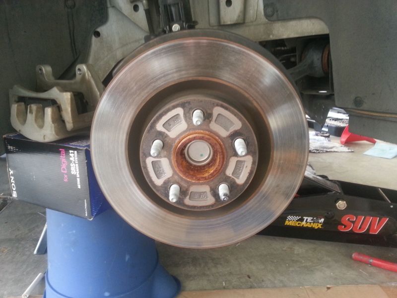

Hey guys I just replaced my front rotors and pads today. I went with ACDelco rotors and hawk pads. Everything went fine, but when I went to bed the new pads in there is a wierd noise coming from the right side. It looks like something is rubbing on the rotor because there is a line all the way around. Any ideas? Below are before and after pics along with a video of the noise.

Are you suppressing the brakes at all in the video or are you just coasting? Also, can you post a pic of the line across the new rotors? It could be the slider clips weren't positioned properly.

No I was just coasting. I ended up taking the caliper back off and it was one of the clips that was bent out a little to much. Bent them again and fixed the problem. Thanks though.
