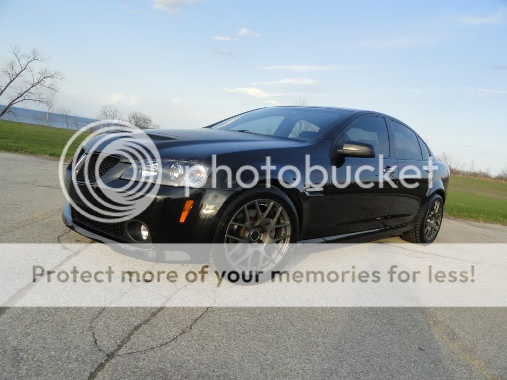

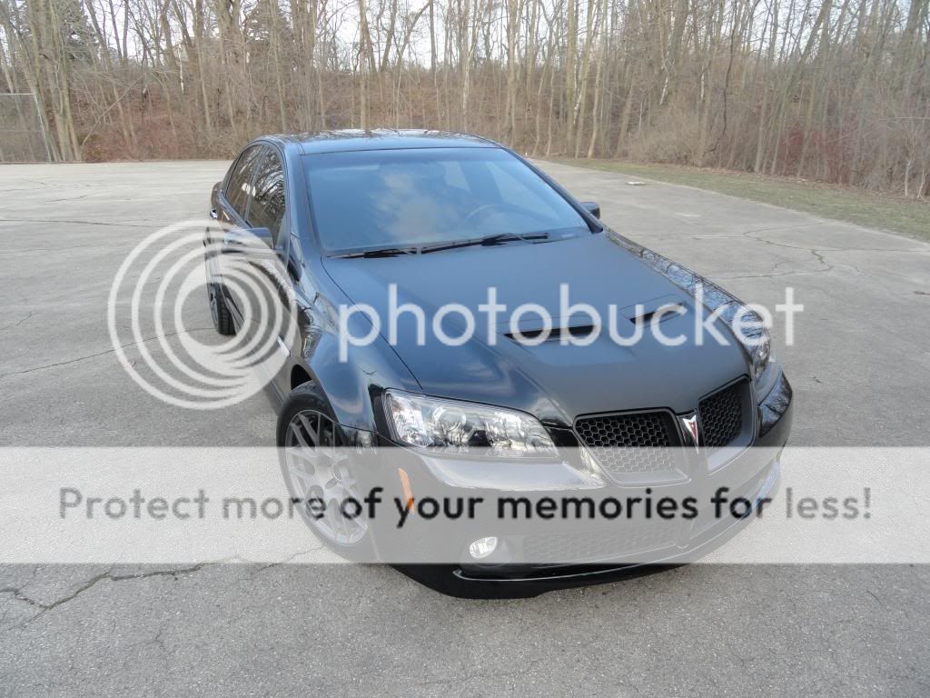

They are 18x9.5 all the way around just like matthewo's setup. I am lowered on Eibachs as well. I went with Nitto nt555 in a 275-40-18. I think they look awesome. And I love having the nice big meats up front it handles like a dream. I cut the rear fenders just in case I might rub, but I have had zero issues with rubbing since I installed them.

Looks really good, nice and meaty tires. This is why I am torn between 18s and 19s.
Do you find the 275s in the front grab the grooves/wear in the road and tend to pull the car one way or another?

I'm not big on 18's, but when done right they can look really good. Nice work, they look great and I've thought about a set of Nurburgrings myself.

Yes I do notice that it does pull the car a little if there are any ruts in the road that it can grab onto. But it is minimal overall.

Welcome to the club!!

Sorry to raise this from the dead, but... ActionJack, do you think you could've gotten away without rolling your fenders with your setup? My setup is going to be FE3's with Eibachs. I'm planning on doing a staggered setup but my rear will be just like yours, 18x9.5 with 275/40-18. I'd love to know in advance if I should plan on rolling my fenders or not. Thanks for any input. Looks great by the way!

Looks beautiful OP! Curious about the rears rubbing without the cutting as well...
This might be my next setup if I end up staying with the 18's.

Im not really sure if they are going to rub with out rolling or cutting the fenders. I just cut mine to be on the safe side. But it was a minimal amount that I cut off about 1/3rd of an inch max.

You'll rub. :)

I used to poo poo 18's. Now that I realize I have crap for traction with 20's I wish I had 18's LOL. Lookin' good bro!! Stance on Eibachs is spot on too.

Hey what offset or spacer size did u use for the fronts?
They should be 18x9.5" +40et all around. No spacer needed on front, roll needed on rear fender to prevent rub.
