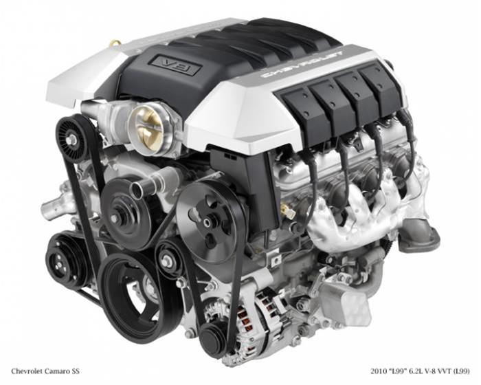

The L77 is also a great alternative. It is a complete motor, so no hours swapping parts and gaskets. Only thing you have to swap is your silver blade throttle body. New water pump new alternator new power steering pump. Better fuel injectors. It also has the new style lifters so no death tick later on. Make you totally reliable in one shot. At $5727.00 it’s drop it in. Fill with oil and coolant and drive away.
Summit racing and many others have it.
Engine - GM (19256262)

#22 ·
Not positive but that picture,might be misleading .
Found same part, number,as a long block too.
Your photo, maybe too good to be true ?
If it really had all the accessorys, front drive ,etc that would be unbeatable.
All the front stuff I bought for my LS7 was a couple grand by itself
#23 · (Edited)
Look at your photo! Those are cathedral heads and a iron block. :ROFLMAO: If you look at GM sites, 19256262 is listed as a Engine Complete Assembly. Not just a long block. A call to the seller would confirm it. This one appears to be assemble line replacement/ warranty engine.
#29 ·
My point , you cant nessasarily trust the pictures
If true, dressed L99 for less
Personally I think they are "file photos"
Happy to be wrong though ,,, and admit it,,, as it means there are some fantastic deals to be had.
#30 ·
Over three months ago, this was asked on Summit Racking and hasn't received a response, "Does this motor come "fully dressed" with all accessories that are pictured"? As mentioned, best to call and inquire.
#32 · (Edited)
See below
[ORDER INQUIRY] - Part number 19256262
BRIAN CULLEN MOTORS <parts@briancullen.com>
Fri 2021-06-18 5:21 AM
Good Morning,
See attached for what is included with the engine.
Thanks!
Cullen GM Parts Direct
Edit:
Anyone see that fully dressed engine photo on an actual GM sight along with that part number?
Anyone else have a reply in writing from a seller of that part number stating the engine fully dressed with accessories?

#33 ·
Contacted Summit Racing via chat. Below is the unedited transcript.
Me:
Hello,
Does the 19256262 engine setup come fully dressed? As pictured with the alternator, power steering, pump, air conditioner compressor, and other accessories already installed?
Summit: After looking on the vendors site it looks like this item has been discontinued and will not be available anymore. I will have to have our site updated
Me: Part number NAL-19256262
Me: Okay. How about NAL-12631106 ?
Summit: They are showing this also Discontinued
Me: Very interesting. Will both listings before removed from the website? Thanks
Summit: I am having both removed from our site
Me: Sound great. Have a great day.
#34 ·
And now from my dealer
19256262 engine assembly ,
Manifolds, TB , coils , water pump , damper, oil pan
NO AC , NO PS, NO ALT,
1000 UNITS AVAILBLE IN NORTH AMERICA
12631106 long block assembly
Water pump, damper, oil pan.
No intake , exhaust manifolds, coils, injectors
245 UNITS AVAILBLE IN NORTH AMERICA
My dealer photos show them as what they are .
One an assembly, one a long block
Neither are or were complete dressed like the beauty photos.
