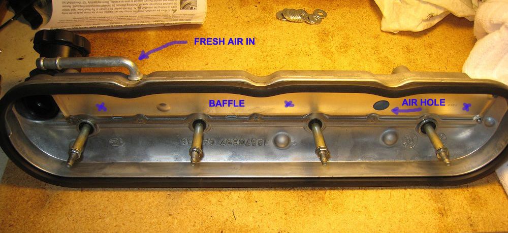

Holley valve covers will work just fine UNLESS you have an engine with AFM hardware (like a stock L76) and your PCV foul/oily air line connects to the valve cover.
Holley valve covers have no restrictor (orifice) in them to restrict oil from being sucked straight out of the drivers side valve cover, down the PCV foul air line, and into the intake manifold. They often do not have baffling, shielding the small nipple to stop large oil droplets from shooting out straight down your PCV line to the intake manifold.
Have a look at your stock left hand side valve cover...you'll see a small 3mm hole (restrictor) down the inside of this nipple pictured. You'll also find tin plate oil deflector baffling under the roof.
3mm hole down the centre is the PCV orifice (restrictor)

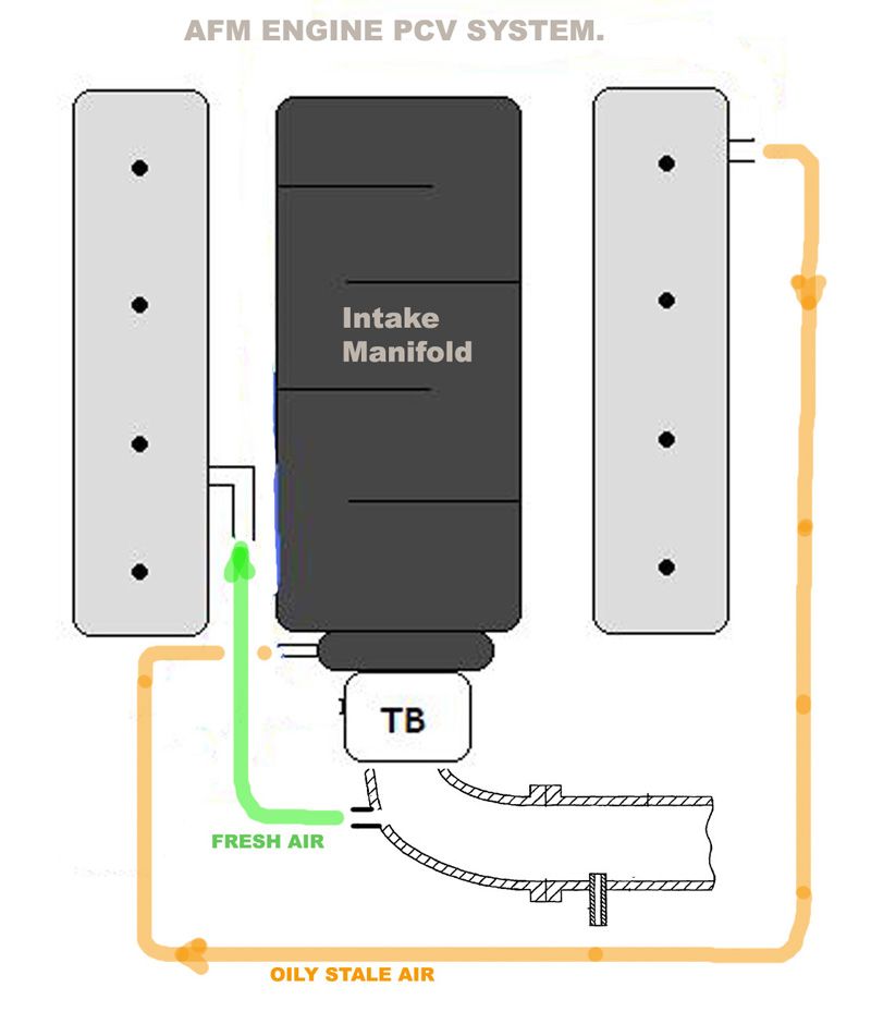

Put your stock valve covers back on and return the PCV plumbing back to stock configuration. Note the flow direction arrows for an engine with AFM hardware...that's how the system is supposed to work.
The nipple on the passenger side is for fresh (filtered and measured by MAF) air into the engine.

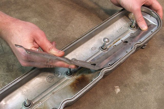

#13 · (Edited)
Here's a pic from underneath a stock GM right hand valve cover....the tin plate near the roof of the valve cover is a baffle to stop bulk oil from going out of the nipple.
Left hand valve cover with an AFM engine it's even more important to have a baffle because the PCV system "sucks" from the left side valve cover.
Pic of an oil deflector baffle being removed.
