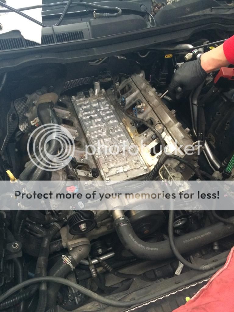

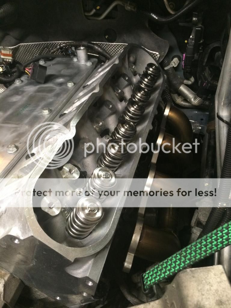

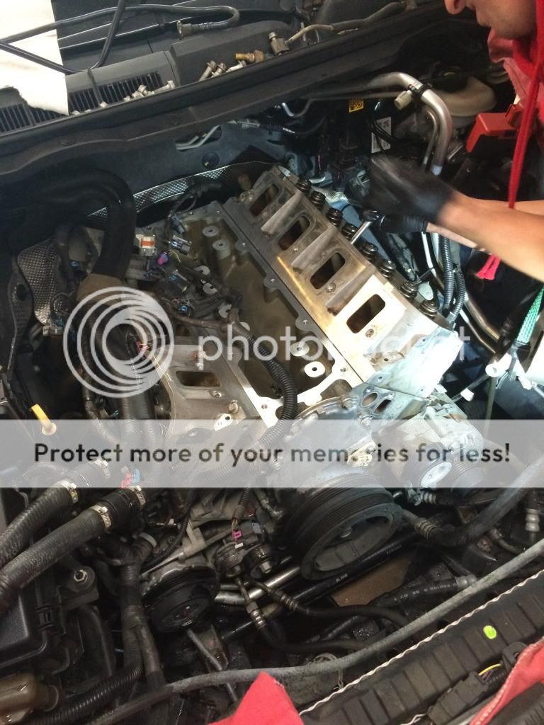

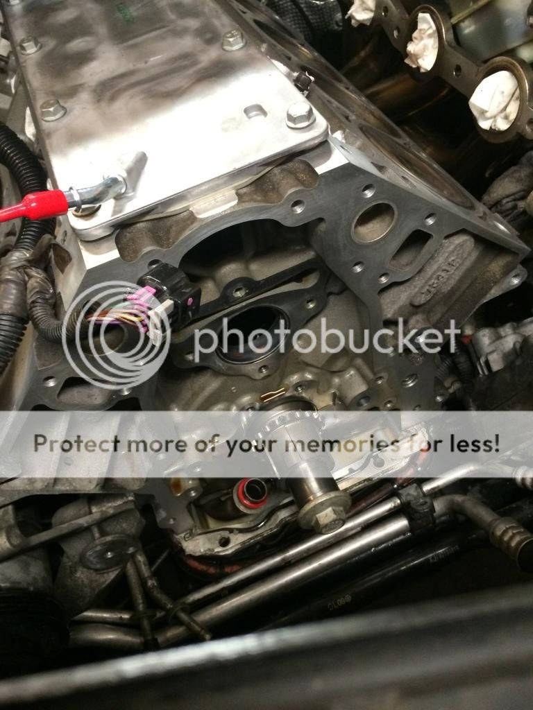

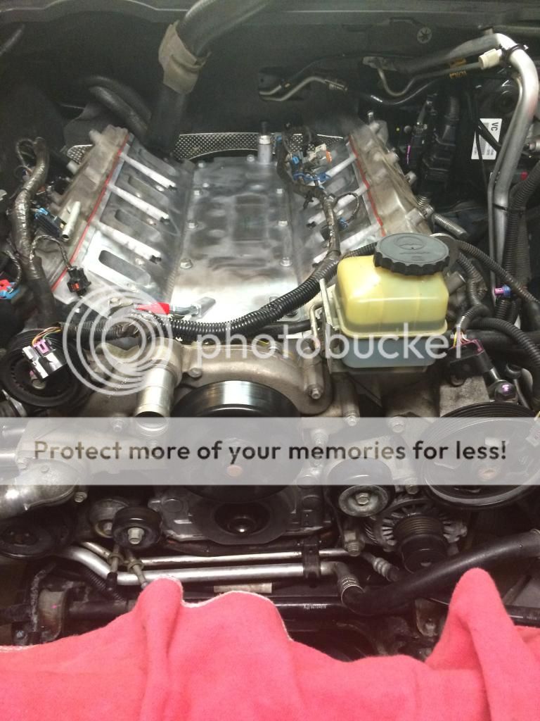

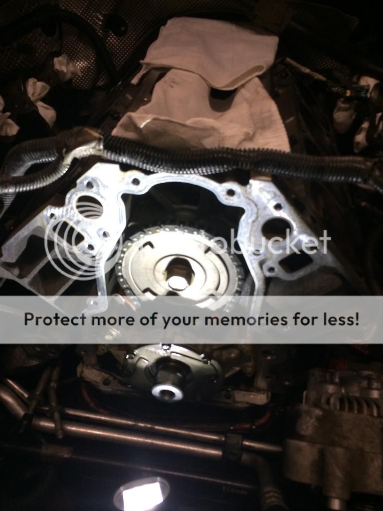

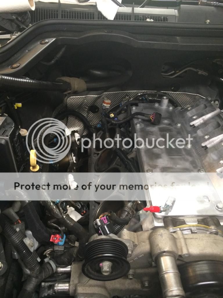

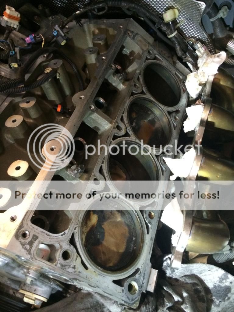

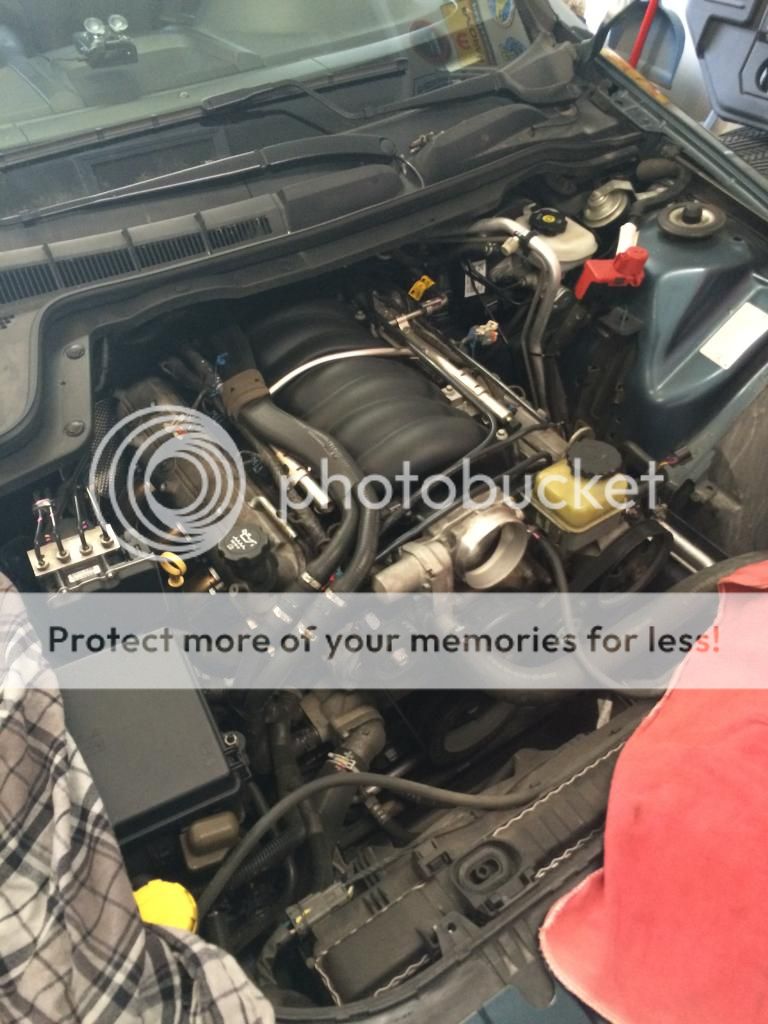

just wanted to share my install so far. cam is a 219/223 .612/.615 112+1 I had the heads sent out and milled .035 and back cut hollow intake valves installed along with the brian tooley spring kit. biggest pain in the butt is the darn pick up tube bolt lol. here are some pics so far that I have taken.
#2 ·
lol don't know why I loaded the pics backwards but anyways the first pic is the last time I worked on it. not that much more to go! should fire it up tomorrow as I got my start up tune this morning from pat then it will be time to data log

I was going to say, DAMN what catch can do you have installed! The intake runners looked a little clean!

You can come check it out whenever you want. It's running pretty well right now with just the start up tune pat sent me. I'm going to data log it and send him the files so he can make the correct adjustments. but for a startup tune it runs pretty well

yea that bolt is the worst. I just loosened the oil pan and dropped it down just enough to beable to spin it out and back in. I lubed the oil pump o-ring really well and took the oil pump apart so I can watch it go in nice and easy. the car is rather easy to work on as im a tech by trade but I work on Hondas all day at the dealership lol so its fun to work on something fun for once lol.
