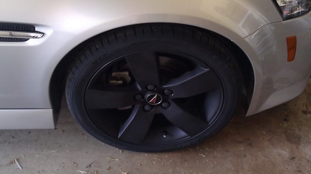

So, I just applied Plasti Dip to my stock GT Sport rims. I have to say, I think it looks FANTASTIC! It's exactly the look I was trying to achieve.
Other Plasti Dip adopters will attest that this product is very durable. Here is a rundown and pictorial:
1. Home Depot/Lowes/Ace: I used four cans of aerosol flat black Plasti Dip. Total cost: $26.00 for all four cans, and 1$ for two packages of index cards.

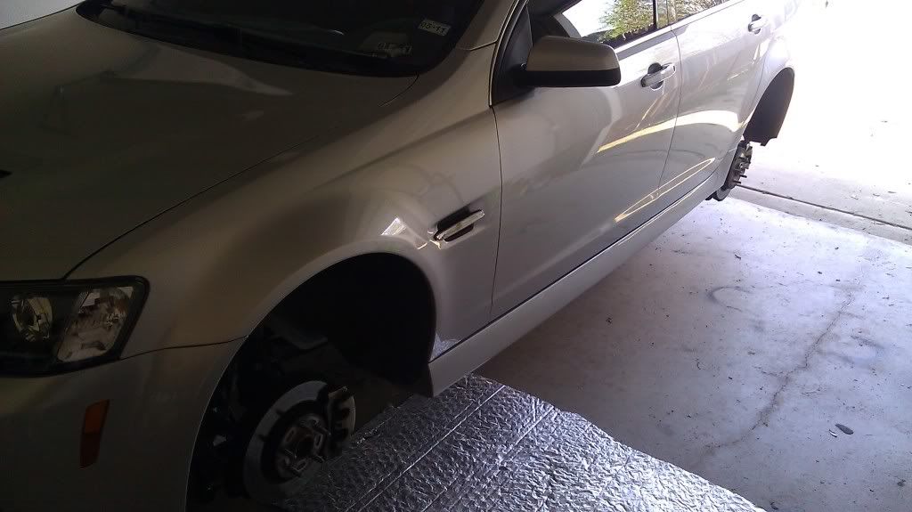

2. Jacked the car up and removed the rims. Used a 3 ton floor jack and four 3 ton jack stands.
3. Thoroughly clean rims with dish detergent (because of its degreasing properties):

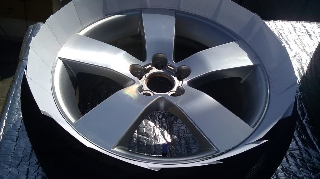

4. IMPORTANT step: Place index cards around the rim to protect the tires. This is MUCH easier than tape. Plasti Dip is a rubberized compound. If you apply tape and do not take it off right away, the plasti will bond to the tape and could peel off of your rim when you remove it. Put painters masking tape over the valve stems!

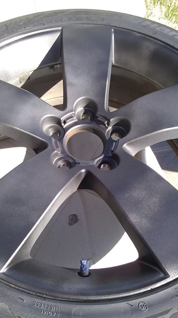

5. Spray the base coat. Don't be discouraged. The first coat looks terrible. This is the first of four coats. NOTE: When spraying, hold the can approximately 6-8" away from the rim. Use even strokes, and don't linger in one place. Sticking to this method will ensure drip free results.

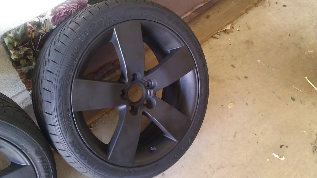

6. After four coats, still a bit mottled because it needs to cure for another 2 hours.

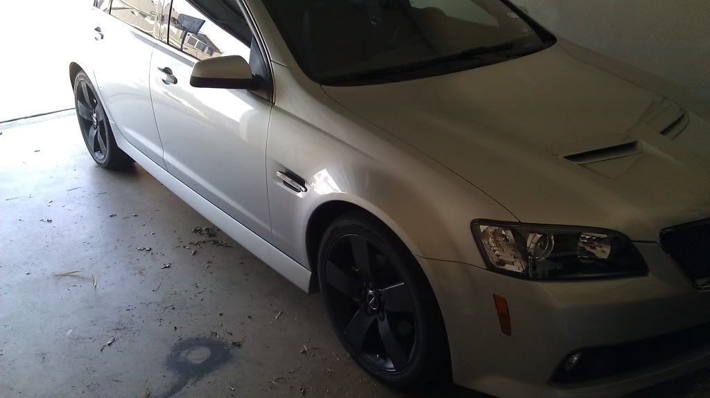

7. All finished. Mounted on the GT, down on the ground, ready to roll tomorrow (want to let it cure all night).

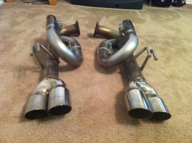

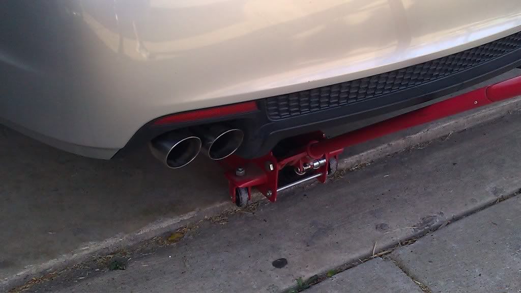

8. Finally: Install a Solo Axel Back system on your car while it is on jack stands. This takes about 15 minutes, totally A W E S O M E!

Alright, just posted the final results: See first post by me. Looooong day :)
#12 ·
No GPDan, the pics above are the only ones I have at the moment. The car is still in the garage because I want to allow the plasti dip to cure overnight. I will get some "far away" pics once the car is cleaned up.
#11 ·
Looks great!!! Love the black wheels.

Nice yeah when I did mine back in Sept... these index cards would have def saved me some time....Tapng the tires took to much time lol Nice job you will not be dissapointed. I rode on mine all winter in 10+ inches of snow here in MD No problems with salt or any chipping at all Extremely durable. Good job my man :) Good to see others doing this more because I think it was only me and 1 other member that tried it and everyone was so worried about brake dust and how to clean and all this stuff...But once done as you did and take your time they come out great! We need to open a Post your pics of plastic dipped wheels.....

No jack stand pics, I got out from under there as soon as I could! I positioned the front jacks directly beside the rotors, meaning you could see them almost paralel to the front assembly. Same with the rears, except just in and in front of the rotors. There are a few places to put the stands.
