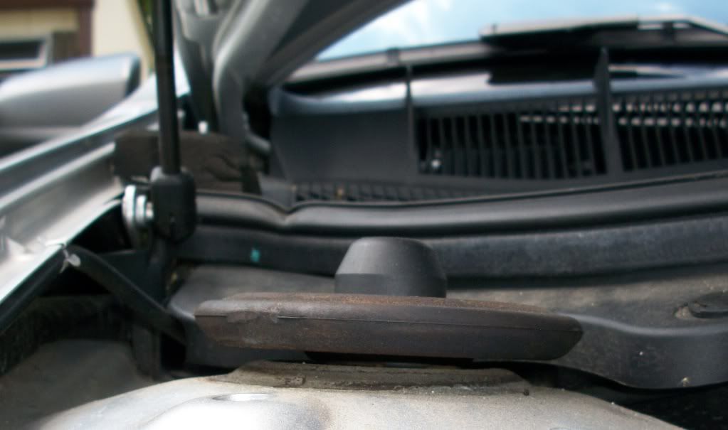

Guys, let's start tracking pix of what the front strut bushings (what we can see from the towers under the hood) look like and at what mileage. All pix should be taken on flat, level ground with wheels straight.
Whether you have issues or not, this might be good to monitor how they deform or crush over time, in case you want to replace them.
Please post pix with mileage and any material description i.e. stock rubber, Pedders rubber, Lovell's poly, BMR poly, etc, etc so we can see how any stock or aftermarket solution holds up over time.
I'll start it off:
30,000-35,000 Miles. Stock Rubber Bushings.
Brand New GM Rubber Bushings installed at 35,900 Miles.
I will try to take pix of mine at 5,000 mile intervals.
Hopefully, my buddy AL (Monty) can keep tabs on his new BMR Poly ones over time to see how they hold up.

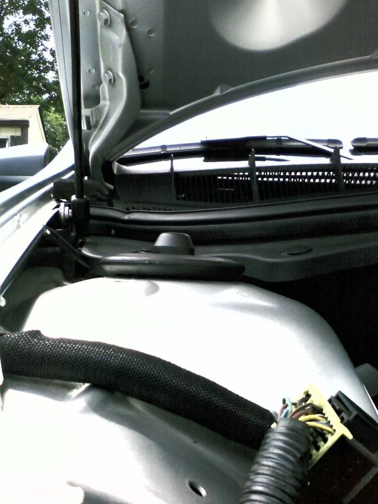

BMR Poly strut mounts at approx 25,000 miles with some spirited driving :gears: Still look the same.
Thanks for posting those Shawn. They look good. Nice to know the BMR polys are holding up!

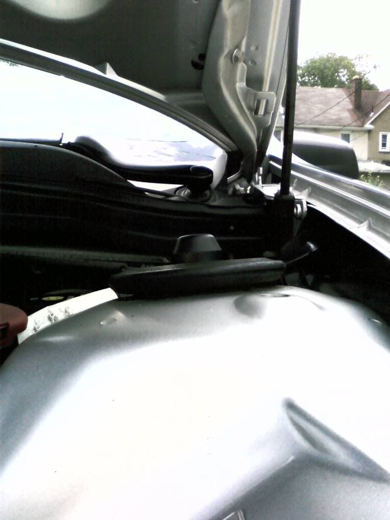

I was just inspecting my strut bushings. On level ground, one has more of a gap than the other between the upper strut mount and the bushing itself.
Does anyone know what the torque specs are for the nuts on top of the bushings? I can easily move mine a little with an adjustable wrench but it moves the entire bushing too somewhat.
I will say this...mine look NOTHING like the BMR bushings in this thread. How do I know if they have gone bad?

If you've got a gap like the first pic, you've got collapsed strut bushings.
If you can fit your little finger between the rubber top and body, you've got collapsed strut bushings.
